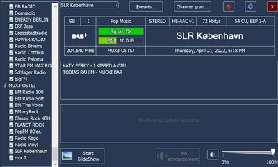

9B Kopenhagen hat nun auch mal wieder Nachwuchs bekommen.
Ensemble 0x9102, Label: 'MUX3-OSTSJ', ShortLabel: 'MUX3-OST', LTO: +120 min, ECC: 0xE1, NumServices: 11
Audio-Service 0x9199, Label: 'PopFM 80'er.', ShortLabel: 'PopFM 80', PTY: Pop Music (dynamic), AnnouncementSupport: No, NumComponents: 1 (Audio: 1, Data: 0)
AudioComponent, SCIdS: 0, Label: '', ShortLabel: '', ASCTy: 0x3F (AAC), SubChId: 3, StartCU: 540, NumCU: 72, ErrorProt: EEP 3-A (FEC: 1/2), Datarate: 96 kbit/s, NumUserApps: 1
Audio-Service 0x9619, Label: 'BM The Voice', ShortLabel: 'BM Voice', PTY: Pop Music (dynamic), AnnouncementSupport: No, NumComponents: 1 (Audio: 1, Data: 0)
AudioComponent, SCIdS: 0, Label: '', ShortLabel: '', ASCTy: 0x3F (AAC), SubChId: 5, StartCU: 126, NumCU: 72, ErrorProt: EEP 3-A (FEC: 1/2), Datarate: 96 kbit/s, NumUserApps: 1
Audio-Service 0x9624, Label: 'BM myRock', ShortLabel: 'BM myR', PTY: Rock Music (dynamic), AnnouncementSupport: No, NumComponents: 1 (Audio: 1, Data: 0)
AudioComponent, SCIdS: 0, Label: '', ShortLabel: '', ASCTy: 0x3F (AAC), SubChId: 4, StartCU: 54, NumCU: 72, ErrorProt: EEP 3-A (FEC: 1/2), Datarate: 96 kbit/s, NumUserApps: 1
Audio-Service 0x96EA, Label: 'PLANET ROCK', ShortLabel: 'PL ROCK', PTY: Rock Music (dynamic), AnnouncementSupport: No, NumComponents: 1 (Audio: 1, Data: 0)
AudioComponent, SCIdS: 0, Label: '', ShortLabel: '', ASCTy: 0x3F (AAC), SubChId: 9, StartCU: 612, NumCU: 72, ErrorProt: EEP 3-A (FEC: 1/2), Datarate: 96 kbit/s, NumUserApps: 1
Audio-Service 0x9729, Label: 'Radio Vinyl', ShortLabel: ' Vinyl', PTY: Oldies Music (dynamic), AnnouncementSupport: No, NumComponents: 1 (Audio: 1, Data: 0)
AudioComponent, SCIdS: 0, Label: '', ShortLabel: '', ASCTy: 0x3F (AAC), SubChId: 2, StartCU: 396, NumCU: 72, ErrorProt: EEP 3-A (FEC: 1/2), Datarate: 96 kbit/s, NumUserApps: 1
Audio-Service 0x973F, Label: 'BM Radio 100', ShortLabel: 'BM R100', PTY: Pop Music (dynamic), AnnouncementSupport: No, NumComponents: 1 (Audio: 1, Data: 0)
AudioComponent, SCIdS: 0, Label: '', ShortLabel: '', ASCTy: 0x3F (AAC), SubChId: 6, StartCU: 198, NumCU: 72, ErrorProt: EEP 3-A (FEC: 1/2), Datarate: 96 kbit/s, NumUserApps: 1
Audio-Service 0x97A2, Label: 'BM Radio Soft', ShortLabel: 'BM RSoft', PTY: Pop Music (dynamic), AnnouncementSupport: No, NumComponents: 1 (Audio: 1, Data: 0)
AudioComponent, SCIdS: 0, Label: '', ShortLabel: '', ASCTy: 0x3F (AAC), SubChId: 7, StartCU: 270, NumCU: 72, ErrorProt: EEP 3-A (FEC: 1/2), Datarate: 96 kbit/s, NumUserApps: 1
Audio-Service 0x984C, Label: 'Radio Køge', ShortLabel: 'R Køge', PTY: Pop Music (dynamic), AnnouncementSupport: No, NumComponents: 1 (Audio: 1, Data: 0)
Audio-Service 0x9A53, Label: 'SLR København', ShortLabel: 'SLR Kbh', PTY: Pop Music (dynamic), AnnouncementSupport: No, NumComponents: 1 (Audio: 1, Data: 0)
AudioComponent, SCIdS: 0, Label: '', ShortLabel: '', ASCTy: 0x3F (AAC), SubChId: 10, StartCU: 684, NumCU: 54, ErrorProt: EEP 3-A (FEC: 1/2), Datarate: 72 kbit/s, NumUserApps: 1
Audio-Service 0x9E24, Label: 'mix 7.', ShortLabel: 'mix 7.', PTY: Pop Music (dynamic), AnnouncementSupport: No, NumComponents: 1 (Audio: 1, Data: 0)
AudioComponent, SCIdS: 0, Label: '', ShortLabel: '', ASCTy: 0x3F (AAC), SubChId: 0, StartCU: 468, NumCU: 72, ErrorProt: EEP 3-A (FEC: 1/2), Datarate: 96 kbit/s, NumUserApps: 1
Audio-Service 0x9EB1, Label: 'Classic Rock KBH', ShortLabel: 'Cla Rock', PTY: Rock Music (dynamic), AnnouncementSupport: No, NumComponents: 1 (Audio: 1, Data: 0)
AudioComponent, SCIdS: 0, Label: '', ShortLabel: '', ASCTy: 0x3F (AAC), SubChId: 8, StartCU: 342, NumCU: 54, ErrorProt: EEP 3-A (FEC: 1/2), Datarate: 72 kbit/s, NumUserApps: 1
2178.jpg [ 9.45 KiB | 3124-mal betrachtet ]
9Bkobenhagen.jpg [ 103.84 KiB | 3128-mal betrachtet ]
BeitragVerfasst: Do 21. Apr 2022, 21:10
oh, das ist ja toll! SLR mein zuständiges Lokalradio hier im Süden (Vordingborg, Mön). 8-)
sehr seltsam dass die in Kopenhagen senden, die Verwegslung mit "Stevns Lokal Radio SLR" ist durchaus gegeben.
ich kenne Orte da kann man beide empfangen, vor allem in Südschweden (Skane län).
dann hoffe ich mal dass SLR demnächst auch im (eigentlich richtigen) 11A auftaucht.
bisher muss ich SLR auf UKW hören (101,0 und 101,1 MHz) und da ist nachts (werktags) Sendepause.
da bin ich aber mal gespannt ob im DAB 9B nachts auch nur 3 Stunden lang Stille schweigt!
mit DAB hätte ich dann erstmals rund um die Uhr SLR :)
