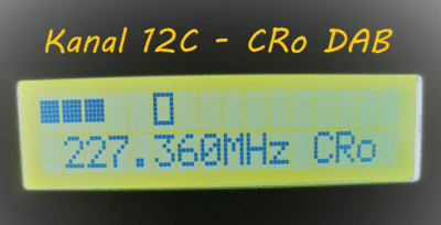

12C - "CRo DAB+", Bukova Hora Usti nL (Verona 1) - 07.06.2021 10000 Watt, ca. 400 km - https://forum.digitalradio-in-deutschla ... d=5566&t=1
