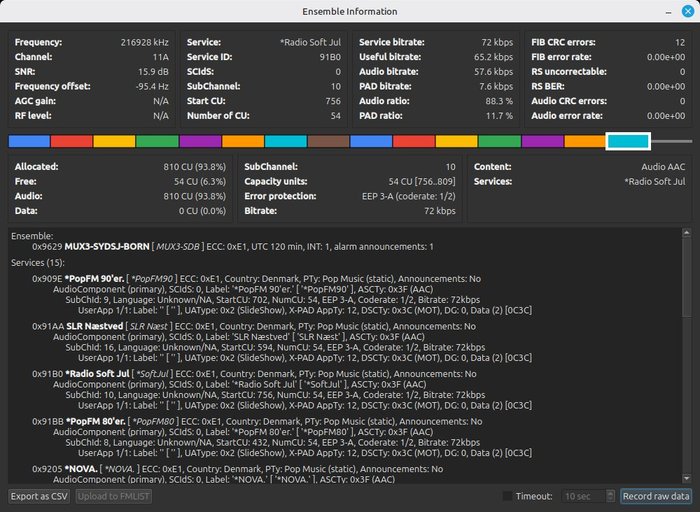

BeitragVerfasst: So 12. Okt 2025, 23:32
Ich habe ja schon nach VLR Jul im 11A Ausschau gehalten aber was taucht nun ploetzlich auf: Radio Soft Jul. :o
9731.jpg [ 17.48 KiB | 2197-mal betrachtet ]
SoftJul.jpeg [ 95.25 KiB | 2197-mal betrachtet ]

0x9CC5 Globus Guld [ Guld ] ECC: 0xE1, Country: Denmark, PTy: Pop Music (static), Announcements: No
AudioComponent (primary), SCIdS: 0, Label: 'Globus Guld' [ 'Guld' ], ASCTy: 0x3F (AAC)
SubChId: 9, Language: Danish, StartCU: 276, NumCU: 54, EEP 3-A, Coderate: 1/2, Bitrate: 72kbps
0x9D10 Classic.fm [ Classic ] ECC: 0xE1, Country: Denmark, PTy: Pop Music (static), Announcements: No
AudioComponent (primary), SCIdS: 0, Label: 'Classic.fm' [ 'Classic' ], ASCTy: 0x3F (AAC)
SubChId: 12, Language: Danish, StartCU: 438, NumCU: 54, EEP 3-A, Coderate: 1/2, Bitrate: 72kbps
0x9DFA VLR [ VLR ] ECC: 0xE1, Country: Denmark, PTy: Pop Music (static), Announcements: No
AudioComponent (primary), SCIdS: 0, Label: 'VLR' [ 'VLR' ], ASCTy: 0x3F (AAC)
SubChId: 11, Language: Danish, StartCU: 384, NumCU: 54, EEP 3-A, Coderate: 1/2, Bitrate: 72kbps
0x9E7F Skala Sydfyn [ SkalaSyd ] ECC: 0xE1, Country: Denmark, PTy: Pop Music (static), Announcements: No
AudioComponent (primary), SCIdS: 0, Label: 'Skala Sydfyn' [ 'SkalaSyd' ], ASCTy: 0x3F (AAC)
SubChId: 14, Language: Danish, StartCU: 762, NumCU: 54, EEP 3-A, Coderate: 1/2, Bitrate: 72kbps
0x9F10 Classic Sydfyn [ Clas Syd ] ECC: 0xE1, Country: Denmark, PTy: Pop Music (static), Announcements: No
AudioComponent (primary), SCIdS: 0, Label: 'Classic Sydfyn' [ 'Clas Syd' ], ASCTy: 0x3F (AAC)
SubChId: 15, Language: Danish, StartCU: 546, NumCU: 54, EEP 3-A, Coderate: 1/2, Bitrate: 72kbps
