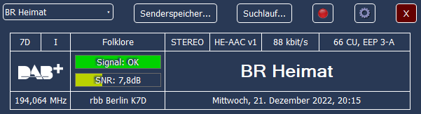

BR Heimat ersetzt Bayern 2 auf dem Kanal 7D. Slideshow und Bilder sind wie im 11D Bayern.
BR Heimat Kanal 7D.PNG [ 13.14 KiB | 3012-mal betrachtet ]
Belegt: 786 CU (91,0%), Frei: 78 CU (9,0%)
Audio: 762 CU (88,2%), Daten: 24 CU (2,8%)
Ensemble 0x1019, Label: 'rbb Berlin K7D', ShortLabel: 'Berlin7D', LTO: +60 min, ECC: 0xE0, AlarmFlag: 0, NumServices: 14
Audio-Service 0xD314, Label: 'BR-Klassik', ShortLabel: 'BR-Klass', PTY: Serious Classical (dynamic), AnnouncementSupport: No, NumComponents: 1 (Audio: 1, Data: 0)
AudioComponent, SCIdS: 0, Label: '', ShortLabel: '', ASCTy: 0x3F (AAC), SubChId: 11, StartCU: 528, NumCU: 72, ErrorProt: EEP 3-A (FEC: 1/2), Datarate: 96 kbit/s, NumUserApps: 1
Audio-Service 0xD316, Label: 'BR Schlager', ShortLabel: 'BRSchlgr', PTY: Oldies Music (dynamic), AnnouncementSupport: No, NumComponents: 1 (Audio: 1, Data: 0)
AudioComponent, SCIdS: 0, Label: '', ShortLabel: '', ASCTy: 0x3F (AAC), SubChId: 16, StartCU: 720, NumCU: 66, ErrorProt: EEP 3-A (FEC: 1/2), Datarate: 88 kbit/s, NumUserApps: 1
Audio-Service 0xD321, Label: 'rbb 88.8', ShortLabel: 'rbb 88.8', PTY: Pop Music (dynamic), AnnouncementSupport: Yes, Flags: 0x0002 [Road Traffic flash], NumClusters: 1 [3], NumComponents: 1 (Audio: 1, Data: 0)
AudioComponent, SCIdS: 0, Label: '', ShortLabel: '', ASCTy: 0x3F (AAC), SubChId: 6, StartCU: 324, NumCU: 66, ErrorProt: EEP 3-A (FEC: 1/2), Datarate: 88 kbit/s, NumUserApps: 1
Audio-Service 0xD323, Label: 'rbbKultur', ShortLabel: 'Kultur', PTY: Culture (dynamic), AnnouncementSupport: No, NumComponents: 1 (Audio: 1, Data: 0)
AudioComponent, SCIdS: 0, Label: '', ShortLabel: '', ASCTy: 0x3F (AAC), SubChId: 5, StartCU: 252, NumCU: 72, ErrorProt: EEP 3-A (FEC: 1/2), Datarate: 96 kbit/s, NumUserApps: 1
Audio-Service 0xD332, Label: 'radio1', ShortLabel: 'radio1', PTY: Pop Music (dynamic), AnnouncementSupport: Yes, Flags: 0x0002 [Road Traffic flash], NumClusters: 1 [4], NumComponents: 1 (Audio: 1, Data: 0)
AudioComponent, SCIdS: 0, Label: '', ShortLabel: '', ASCTy: 0x3F (AAC), SubChId: 1, StartCU: 60, NumCU: 66, ErrorProt: EEP 3-A (FEC: 1/2), Datarate: 88 kbit/s, NumUserApps: 1
Audio-Service 0xD333, Label: 'Fritz', ShortLabel: 'Fritz', PTY: Pop Music (dynamic), AnnouncementSupport: Yes, Flags: 0x0002 [Road Traffic flash], NumClusters: 1 [5], NumComponents: 1 (Audio: 1, Data: 0)
AudioComponent, SCIdS: 0, Label: '', ShortLabel: '', ASCTy: 0x3F (AAC), SubChId: 7, StartCU: 390, NumCU: 66, ErrorProt: EEP 3-A (FEC: 1/2), Datarate: 88 kbit/s, NumUserApps: 1
Audio-Service 0xD335, Label: 'rbb24 Inforadio', ShortLabel: 'Info', PTY: Information (dynamic), AnnouncementSupport: Yes, Flags: 0x0002 [Road Traffic flash], NumClusters: 1 [2], NumComponents: 1 (Audio: 1, Data: 0)
AudioComponent, SCIdS: 0, Label: '', ShortLabel: '', ASCTy: 0x3F (AAC), SubChId: 8, StartCU: 456, NumCU: 48, ErrorProt: EEP 3-A (FEC: 1/2), Datarate: 64 kbit/s, NumUserApps: 1
Audio-Service 0xD395, Label: 'WDR 5', ShortLabel: 'WDR 5', PTY: Science (dynamic), AnnouncementSupport: No, NumComponents: 1 (Audio: 1, Data: 0)
AudioComponent, SCIdS: 0, Label: '', ShortLabel: '', ASCTy: 0x3F (AAC), SubChId: 2, StartCU: 126, NumCU: 60, ErrorProt: EEP 3-A (FEC: 1/2), Datarate: 80 kbit/s, NumUserApps: 1
Audio-Service 0xD3A3, Label: 'SWR3', ShortLabel: 'SWR3', PTY: Pop Music (dynamic), AnnouncementSupport: No, NumComponents: 1 (Audio: 1, Data: 0)
AudioComponent, SCIdS: 0, Label: '', ShortLabel: '', ASCTy: 0x3F (AAC), SubChId: 4, StartCU: 186, NumCU: 66, ErrorProt: EEP 3-A (FEC: 1/2), Datarate: 88 kbit/s, NumUserApps: 1
Audio-Service 0xD3A6, Label: 'SWR Aktuell', ShortLabel: 'SWR Aktu', PTY: Information (dynamic), AnnouncementSupport: No, NumComponents: 1 (Audio: 1, Data: 0)
AudioComponent, SCIdS: 0, Label: '', ShortLabel: '', ASCTy: 0x3F (AAC), SubChId: 15, StartCU: 666, NumCU: 54, ErrorProt: EEP 3-A (FEC: 1/2), Datarate: 72 kbit/s, NumUserApps: 1
Audio-Service 0xD431, Label: 'Antenne P', ShortLabel: 'Ant P', PTY: Pop Music (dynamic), AnnouncementSupport: Yes, Flags: 0x0002 [Road Traffic flash], NumClusters: 1 [1], NumComponents: 1 (Audio: 1, Data: 0)
AudioComponent, SCIdS: 0, Label: '', ShortLabel: '', ASCTy: 0x3F (AAC), SubChId: 0, StartCU: 0, NumCU: 60, ErrorProt: EEP 3-A (FEC: 1/2), Datarate: 80 kbit/s, NumUserApps: 1
Audio-Service 0xDF16, Label: 'BR Heimat', ShortLabel: 'BRHeimat', PTY: Folk Music (dynamic), AnnouncementSupport: No, NumComponents: 1 (Audio: 1, Data: 0)
AudioComponent, SCIdS: 0, Label: '', ShortLabel: '', ASCTy: 0x3F (AAC), SubChId: 12, StartCU: 600, NumCU: 66, ErrorProt: EEP 3-A (FEC: 1/2), Datarate: 88 kbit/s, NumUserApps: 1
Data-Service 0xE0D01019, Label: 'rbb EPG', ShortLabel: 'EPG', PTY: -, AnnouncementSupport: No, NumComponents: 1 (Audio: 0, Data: 1)
DataComponent (MSC packet data), SCIdS: 0, SCId: 0, Label: '', ShortLabel: '', DSCTy: 0x3C (MOT), SubChId: 9, StartCU: 504, NumCU: 12, ErrorProt: EEP 3-A (FEC: 1/2), Datarate: 16 kbit/s, PacketAddr: 1, NumUserApps: 1
Data-Service 0xE0D11019, Label: 'rbb TPEG', ShortLabel: 'TPEG', PTY: -, AnnouncementSupport: No, NumComponents: 1 (Audio: 0, Data: 1)
DataComponent (MSC packet data), SCIdS: 0, SCId: 1, Label: '', ShortLabel: '', DSCTy: 0x05 (Transparent Data Channel), SubChId: 10, StartCU: 516, NumCU: 12, ErrorProt: EEP 3-A (FEC: 1/2), Datarate: 16 kbit/s, PacketAddr: 2, NumUserApps: 1
