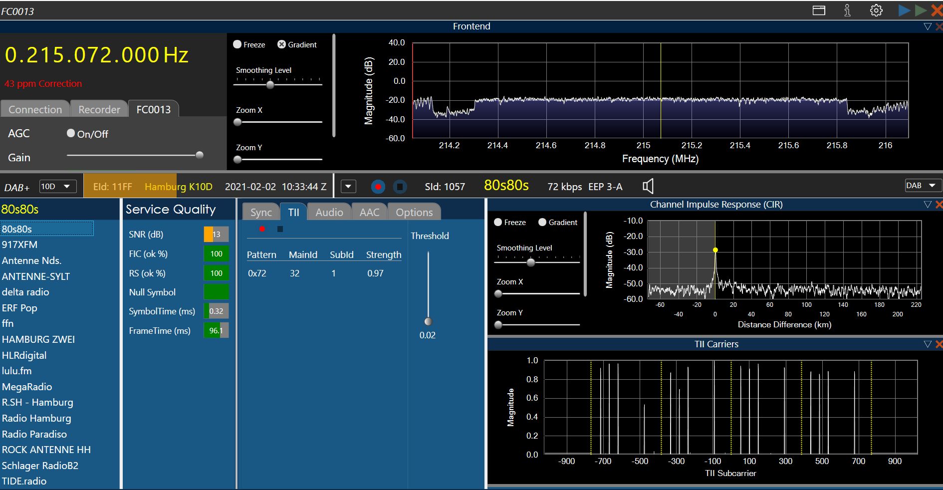

Hier noch 80s80s 10D als Bild, heute ist wieder leichte Tropo.
Anders als R.SH hat delta keine Hamburg Kennung dahinter.
Ensemble 0x11FF, Label: 'Hamburg K10D', ShortLabel: 'Hamburg', LTO: +60 min, ECC: 0xE0, NumServices: 17
Audio-Service 0x1055, Label: '917XFM', ShortLabel: '917XFM', PTY: Other Music (dynamic), AnnouncementSupport: No, NumComponents: 1 (Audio: 1, Data: 0)
AudioComponent, SCIdS: 0, Label: '', ShortLabel: '', ASCTy: 0x3F (AAC), SubChId: 18, StartCU: 660, NumCU: 54, ErrorProt: EEP 3-A (FEC: 1/2), Datarate: 72 kbit/s, NumUserApps: 1
AudioComponent, SCIdS: 0, Label: '', ShortLabel: '', ASCTy: 0x3F (AAC), SubChId: 19, StartCU: 714, NumCU: 42, ErrorProt: EEP 2-B (FEC: 4/7), Datarate: 64 kbit/s, NumUserApps: 1
Audio-Service 0x1057, Label: '80s80s', ShortLabel: '80s80s', PTY: Pop Music (dynamic), AnnouncementSupport: No, NumComponents: 1 (Audio: 1, Data: 0)
AudioComponent, SCIdS: 0, Label: '', ShortLabel: '', ASCTy: 0x3F (AAC), SubChId: 2, StartCU: 0, NumCU: 54, ErrorProt: EEP 3-A (FEC: 1/2), Datarate: 72 kbit/s, NumUserApps: 1
AudioComponent, SCIdS: 0, Label: '', ShortLabel: '', ASCTy: 0x3F (AAC), SubChId: 4, StartCU: 108, NumCU: 54, ErrorProt: EEP 3-A (FEC: 1/2), Datarate: 72 kbit/s, NumUserApps: 1
AudioComponent, SCIdS: 0, Label: '', ShortLabel: '', ASCTy: 0x3F (AAC), SubChId: 6, StartCU: 216, NumCU: 42, ErrorProt: EEP 2-B (FEC: 4/7), Datarate: 64 kbit/s, NumUserApps: 1
Audio-Service 0x131A, Label: 'MegaRadio', ShortLabel: 'Mega', PTY: News (dynamic), AnnouncementSupport: No, NumComponents: 1 (Audio: 1, Data: 0)
AudioComponent, SCIdS: 0, Label: '', ShortLabel: '', ASCTy: 0x3F (AAC), SubChId: 7, StartCU: 258, NumCU: 42, ErrorProt: EEP 2-B (FEC: 4/7), Datarate: 64 kbit/s, NumUserApps: 1
AudioComponent, SCIdS: 0, Label: '', ShortLabel: '', ASCTy: 0x3F (AAC), SubChId: 12, StartCU: 462, NumCU: 54, ErrorProt: EEP 3-A (FEC: 1/2), Datarate: 72 kbit/s, NumUserApps: 1
Audio-Service 0x1735, Label: 'Schlager RadioB2', ShortLabel: 'Schlager', PTY: Pop Music (dynamic), AnnouncementSupport: No, NumComponents: 1 (Audio: 1, Data: 0)
AudioComponent, SCIdS: 0, Label: '', ShortLabel: '', ASCTy: 0x3F (AAC), SubChId: 8, StartCU: 300, NumCU: 54, ErrorProt: EEP 3-A (FEC: 1/2), Datarate: 72 kbit/s, NumUserApps: 1
AudioComponent, SCIdS: 0, Label: '', ShortLabel: '', ASCTy: 0x3F (AAC), SubChId: 15, StartCU: 516, NumCU: 36, ErrorProt: EEP 4-A (FEC: 3/4), Datarate: 72 kbit/s, NumUserApps: 1
Audio-Service 0x1A65, Label: 'ERF Pop', ShortLabel: 'ERF Pop', PTY: Pop Music (dynamic), AnnouncementSupport: No, NumComponents: 1 (Audio: 1, Data: 0)
AudioComponent, SCIdS: 0, Label: '', ShortLabel: '', ASCTy: 0x3F (AAC), SubChId: 10, StartCU: 354, NumCU: 54, ErrorProt: EEP 3-A (FEC: 1/2), Datarate: 72 kbit/s, NumUserApps: 1
AudioComponent, SCIdS: 0, Label: '', ShortLabel: '', ASCTy: 0x3F (AAC), SubChId: 11, StartCU: 408, NumCU: 54, ErrorProt: EEP 3-A (FEC: 1/2), Datarate: 72 kbit/s, NumUserApps: 1
AudioComponent, SCIdS: 0, Label: '', ShortLabel: '', ASCTy: 0x3F (AAC), SubChId: 17, StartCU: 606, NumCU: 54, ErrorProt: EEP 3-A (FEC: 1/2), Datarate: 72 kbit/s, NumUserApps: 1
AudioComponent, SCIdS: 0, Label: '', ShortLabel: '', ASCTy: 0x3F (AAC), SubChId: 16, StartCU: 552, NumCU: 54, ErrorProt: EEP 3-A (FEC: 1/2), Datarate: 72 kbit/s, NumUserApps: 1
AudioComponent, SCIdS: 0, Label: '', ShortLabel: '', ASCTy: 0x3F (AAC), SubChId: 20, StartCU: 756, NumCU: 54, ErrorProt: EEP 3-A (FEC: 1/2), Datarate: 72 kbit/s, NumUserApps: 1
AudioComponent, SCIdS: 0, Label: '', ShortLabel: '', ASCTy: 0x3F (AAC), SubChId: 22, StartCU: 810, NumCU: 54, ErrorProt: EEP 3-A (FEC: 1/2), Datarate: 72 kbit/s, NumUserApps: 1
Audio-Service 0xDA7A, Label: 'Radio Paradiso', ShortLabel: 'Paradiso', PTY: -, AnnouncementSupport: No, NumComponents: 1 (Audio: 1, Data: 0)
AudioComponent, SCIdS: 0, Label: '', ShortLabel: '', ASCTy: 0x3F (AAC), SubChId: 3, StartCU: 54, NumCU: 54, ErrorProt: EEP 3-A (FEC: 1/2), Datarate: 72 kbit/s, NumUserApps: 0
