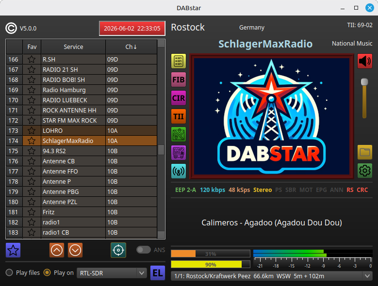

Ensemble:
0x1207 Rostock [ Rostock ] ECC: 0xE0, UTC 120 min, INT: 1, alarm announcements: 0
Services (2):
0x1073 LOHRO [ LOHRO ] ECC: 0xE0, Country: Germany, PTy: Other Music (static), Announcements: No
AudioComponent (primary), SCIdS: 0, Label: 'LOHRO' [ 'LOHRO' ], ASCTy: 0x3F (AAC)
SubChId: 1, Language: German, StartCU: 0, NumCU: 120, EEP 2-A, Coderate: 3/8, Bitrate: 120kbps
0x107F SchlagerMaxRadio [ Schlager ] ECC: 0xE0, Country: Germany, PTy: National Music (static), Announcements: No
AudioComponent (primary), SCIdS: 0, Label: 'SchlagerMaxRadio' [ 'Schlager' ], ASCTy: 0x3F (AAC)
SubChId: 2, Language: German, StartCU: 120, NumCU: 120, EEP 2-A, Coderate: 3/8, Bitrate: 120kbps
10Ahro.png [ 206.14 KiB | 923-mal betrachtet ]

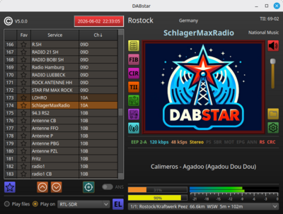

Hier mal das Logo welches gesendet wird.
2026-06-10_222018_0000.jpg [ 49.12 KiB | 702-mal betrachtet ]
